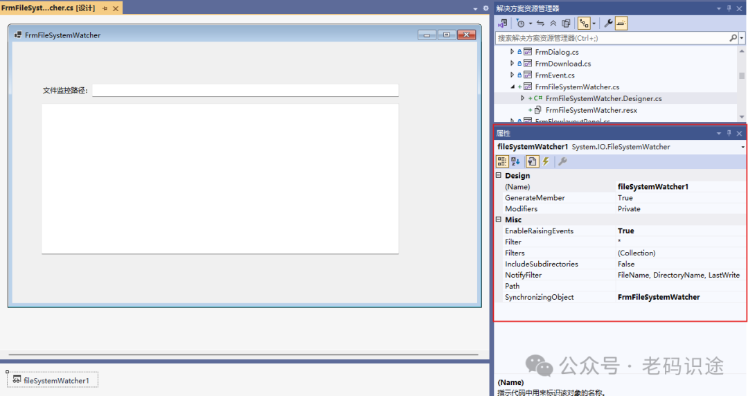

首先拖动FileSystemWatcher控件到Form表单中,由于FileSystemWatcher控件不需要显示在UI页面中,所以在显示底部托盘中,选择控件并在控件的属性窗口中,查看默认属性,如下所示:

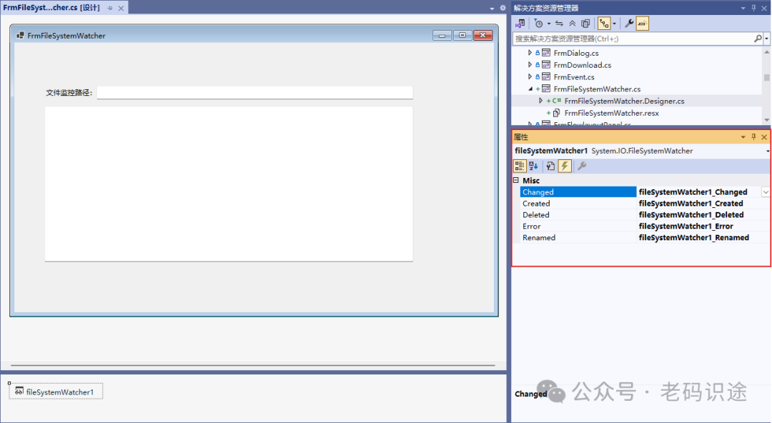

在属性窗口中切换到事件Tab页,然后在对应的Created,Deleted,Changed,Renamed,Error事件文件框中,双击添加对应的事件处理方法,如下所示:
在Form的Load事件中,为FileSystemWatcher控件指定需要监听的路径,和设置是否监听子目录属性,如下所示:
private void FrmFileSystemWatcher_Load(object sender, EventArgs e){    this.fileSystemWatcher1.Path = @"D:\test";    this.fileSystemWatcher1.EnableRaisingEvents = true;//是否启用组件    this.fileSystemWatcher1.IncludeSubdirectories = true;    this.txtFilePath.Text = this.fileSystemWatcher1.Path;    //this.fileSystemWatcher1.NotifyFilter = NotifyFilters.CreationTime;//设置}
在FileSystemWatcher控件的事件处理方法中,增加业务输出逻辑,如下所示:
private void fileSystemWatcher1_Changed(object sender, FileSystemEventArgs e){    this.txtInfo.AppendText(e.FullPath + "被修改了," + e.ChangeType.ToString() + Environment.NewLine);}
private void fileSystemWatcher1_Created(object sender, FileSystemEventArgs e){    this.txtInfo.AppendText(e.FullPath + "被创建了," + e.ChangeType.ToString() + Environment.NewLine);}
private void fileSystemWatcher1_Deleted(object sender, FileSystemEventArgs e){    this.txtInfo.AppendText(e.FullPath + "被删除了," + e.ChangeType.ToString() + Environment.NewLine);}
private void fileSystemWatcher1_Error(object sender, ErrorEventArgs e){    this.txtInfo.AppendText("出错了:"+e.GetException().Message + Environment.NewLine);}
private void fileSystemWatcher1_Renamed(object sender, RenamedEventArgs e){    this.txtInfo.AppendText(e.FullPath + "被重命名了," + e.ChangeType.ToString() + Environment.NewLine);}
